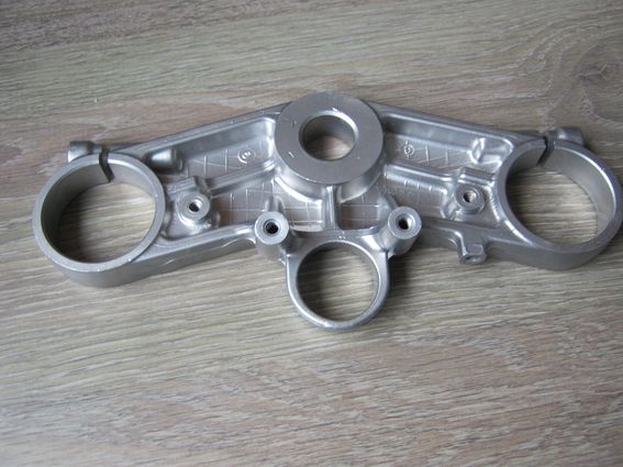

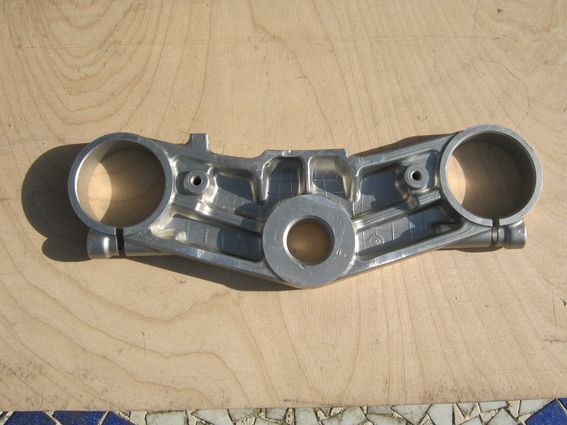

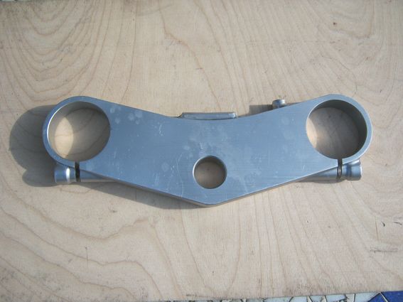

To replace the vj22 RGV fork yokes I obtained ZXR400L yokes. The upper yoke before.......
and after modification- the ignition lock won't be needed.
A bush has to be made to reduce the bore for the steering stem from 25 to 18 mm.

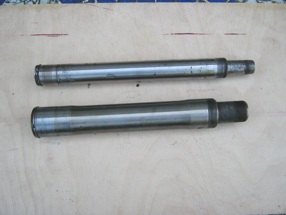

KR-1(S) (upper) and ZXR400L (lower) steering stems:
As the ZXR stem won't fit the KR frame the KR stem will have to be fitted to the ZXR yoke instead. To accept the KR stem a bush will have to be made to take up the difference in diameters between the stems.
