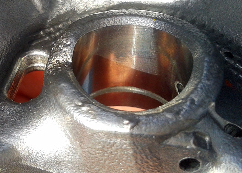

Good morning
I bought the latest Mitaka piston.
a piston has a casting defect in the seat for the piston pin.
it looks like a trough. (left in the images)
perhaps 0.5cm wide and about 2 mm deep.
the piston pin itself fits perfectly.
what do you think?
just a cosmetic problem?
or it can weaken the piston?
otherwise the pistons are good.
Only the piston skirt has a few sharp edges that need to be reworked.
Greetings!
what do you think?
Greetings!

Did you buy two pistons Dirk, or just one?
If you bought two, does the other one have the same defect? Has each piston got the same defect on both sides?
It would be interesting to know whether anyone else's pistons have the same defect as well. I only have the older Mitaka pistons (modified Yamaha 1KT type) - I haven't bought any of the new ones yet.

Re: Mitaka piston casting defect
Hello James
I bought two.
only one piston has the casting defect
regards
I bought two.
regards

I would take both of them back to the supplier and get them checked/replaced. You don't want them letting go as a broken/shattered piston will completely wreck your rebuilt engine

Yes - if you bought two and only one has the defect, then something isn't right. Certainly return the defective one! If you're satisfied that the other one has no defects, there should be no problem, although you may like to ask the supplier anyway. Let us know how you get on.mellorp wrote:I would take both of them back to the supplier...

good morning
I wrote PJME a mail with pictures.
i have not yet received an answer.
unfortunately, I can not speak English.
call does not go ..
i naturally asked a couple of two-stroke specialists, what they think about the damaged.
it is 3: 1
three people say there is no problem.
Clairvoyance can of course none ...
regards
call does not go ..
it is 3: 1
regards

Post them both back to PJE using registered post, and ask for replacements. Why risk it. PJE are notorious for not answering emails and phone calls.

good morning
answer by PJME:
"I have seen this before with cast pistons and I would have no problems with running that piston."
i will install the piston.
regards
answer by PJME:
now 7:2dirk wrote:....
it is 3: 1...
regards

If they have never seen a piston like that before, surely you should be entitled to a replacement and that piston sent back to the manufacturer. If the reply had been, they are all like that, then that would be different.dirk wrote:good morning
answer by PJME:
it is 3: 1...
regards
Are PJE offering to repair your bike for free should the piston fail.
For the price of a piston I would buy another one (The Tuning Works can supply) and send the one you have back to Mitaka direct

Hi all,
It's a casting call misruns. It's due to a too cold mold die or entrapped
air.
In this case, it's due to too cold mold. When you start a production, you have
to preheat the mold quite close to the production temperature.
The right place for this piston is absolutely not an engine.

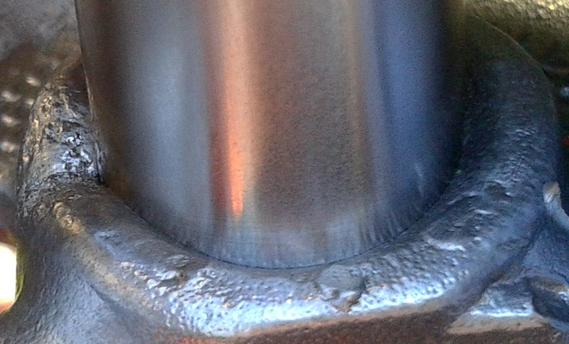

The second picture shows a shrinkaged area, near the piston axle bore, a very stressed area.
air.
