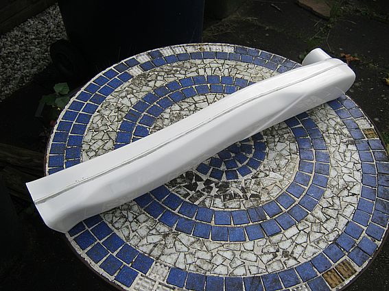

I will be using a 4TW TZ250 fairing, which has two separate intakes for the two airboxes. The RH cylinder gets its air from an intake in the upper fairing's RH leading edge, the intake for the LH cylinder is next to the front number plate area on the LH side. I will be using the LH intake with a 4TW LH air duct:
The stub has an OD of about 50 mm which is a bit marginal for two 35 mm PWKs so it will be replaced with a length of 55 mm OD or 60 mm OD carbon fibre tubing. The duct may require some further alteration but this will be determined when the chassis is assembled and the upper fairing half fitted.

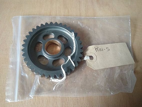

I obtained a brand-new 35-tooth 1st gear for the output shaft from Mark Jordan (thanks, Mark!) which alters the ratio from 2.533 (38/15) to 2.333 (35/15) and closes the gap between 1st and 2nd gear.
The gear was made by Ellis Moore but unfortunately he seems to be out of business,his website disappeared a few years ago.

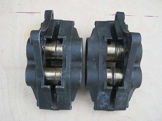

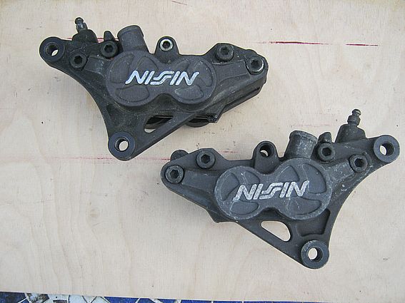

Front brake calipers will be Nissins rather thanTokicos. I will be using vj22 RGV fork legs and the Nissins are a bolt-on replacement. Furthermore they are better than the Tokicos according to the knowledgeable folk at the RGV forum.
I got a pair of used calipers for about 30 pounds each:
They will require a full service plus repainting, so I first pumped out the pistons as faras they would go:

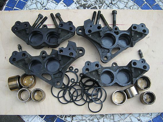

Both calipers stripped:
All the seals will be replaced with new ones. The pistons are still serviceable, but will be replaced with titanium pistons. Titanium doesn't rust, is lighter than steel and has a poor heat conductivity. I looked at Yamaha TZ250 pistons which are aluminium and offer even more weight reduction, but although still available they cost over 100 pounds each- EEK! A set of four titanium pistons is 80 pounds so the choice was easy. The steel Allen bolts will also be replaced with titanium items. Estimated weight saving is about 0.3 kg forthe two calipers, which is of course unsprung weight.

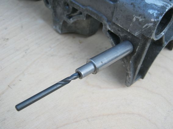

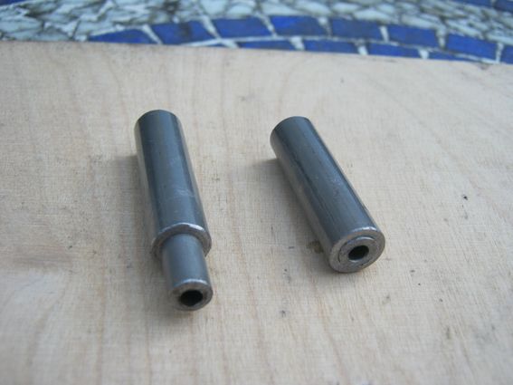

Five of the eight cylinder base studs could be removed, but the remaining three wouldn't budge despite my best efforts:
To aid in removal I obtained lengths of 4 mm ID/8 mm OD, 6 mm ID/8 mm OD and 8 mm ID/12 mm OD steel hydraulic tube, which I used to make drill guides for a 4 mm drill:
These will be used to drill through the studs lengthwise:
As a 4 mm drill was a sloppy fit I obtained a 4.1 mm drill. Now to drill through all three studs. The second stage will be to use 6 mm ID/8 mm OD tube with 8mm ID/12 mm OD tube to make drill guides for a 6mm (nominal) drill. This, if all goes well, will leave a thin-walled stud which can be removed without damaging the threads in the crankcases.
