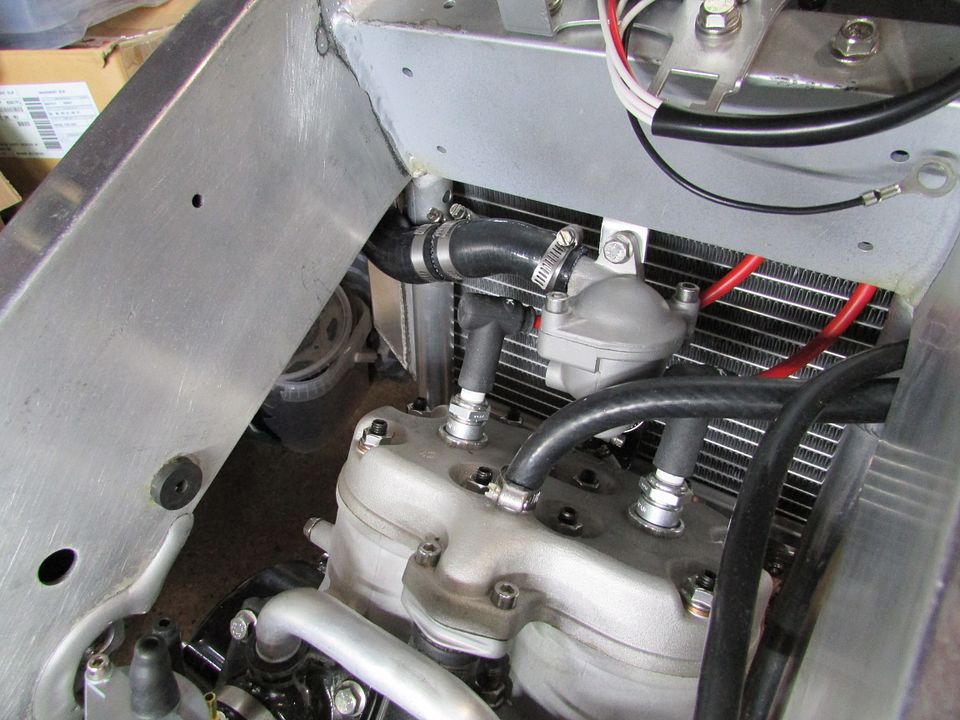

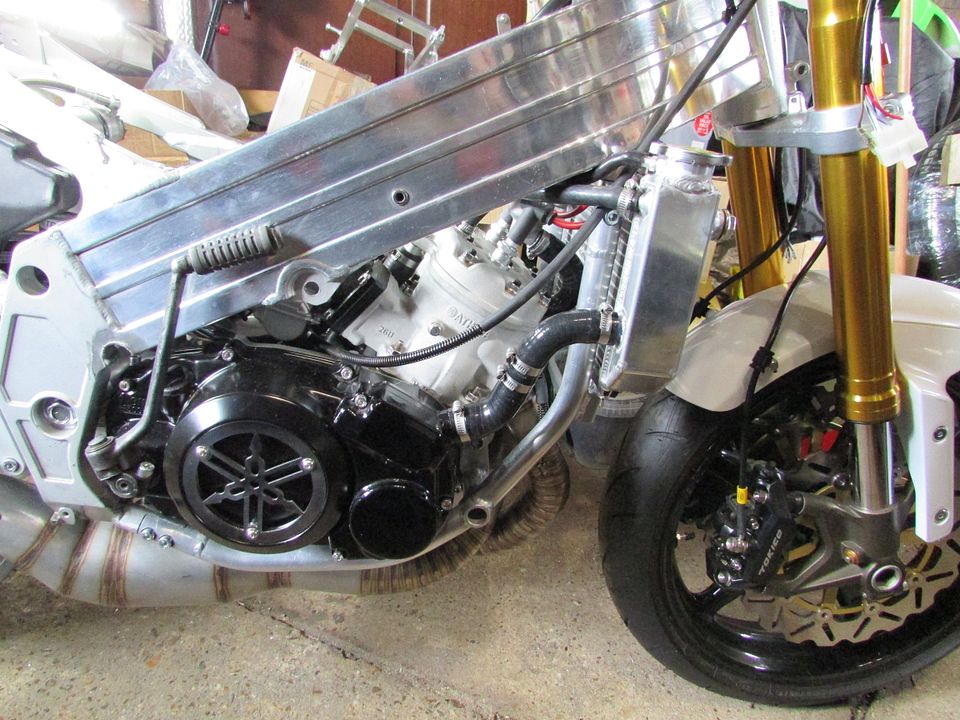

Next thing to work on is getting all the major components mounted satisfactorily so that I can test fit the KR-1 race bodywork, trim anywhere that needs extra clearance for the non-standard bits and get that over to the painter so he can work on it while I am building the wiring loom and sorting out control cables, hoses etc.
The carbs and filters fit with plenty of space to spare - I have made up a bracket to position the rear shock reservoir in the gap left by the absence of the stock KR airbox -
I will be using the same YFZ450 radiator which is a popular upgrade for the KR-1 -
- but with one small addition - the RZ350/Banshee motor has that small bypass hose at the top rear of the cylinder head which has to be connected back to the radiator on the pressurised side of the lower filler cap seal so I have turned up an extra spigot and fitted it to the upper end of the right side tank -
I plan to get the cooling system plumbing done this weekend using a selection of appropriate bends and reducers together with a h***a thermostat housing and a Yamaha 50 degree stat -
