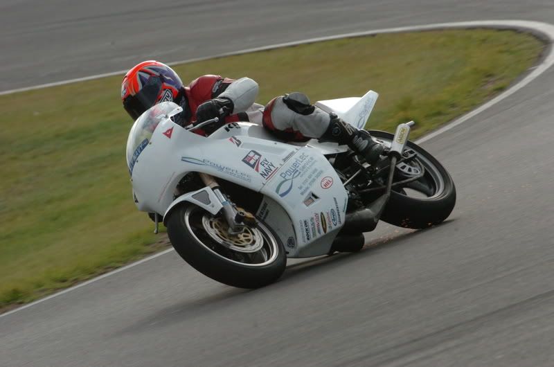

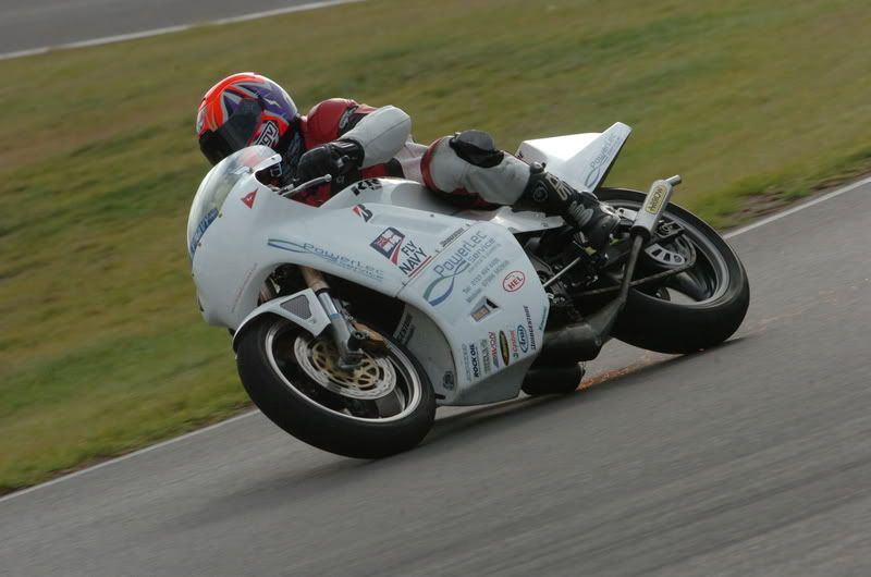

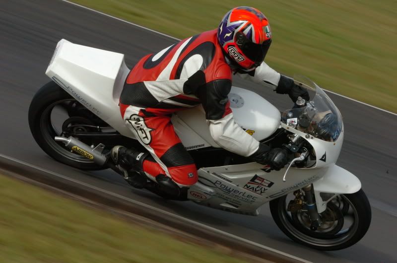

Anglesey 21st sept.....
I AM IN LOVE....
she was fantastic today ..... totally made up with her, run like a dream (apart from floats, fixed kwikly!!)
She was flying, used 15/45 and struggled a bit getting the right gear at some corners, first to high, second too low etc ( a lot of slow tight corners on the coastal circuit)
Scraped holes in both nikkon expansion chambers !!!
Back end feels a little low but brakes were awesome, back end felt like it was in the air everytime i braked !!
KR1 with me was a lad called Dave top bloke and bloody lovely bike..will see it on here soon..
Anglesey is a Fantastic Track loved every inch of it...
oulton park next..
