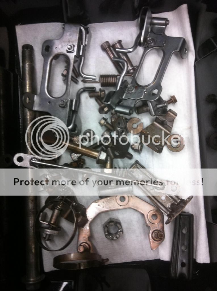

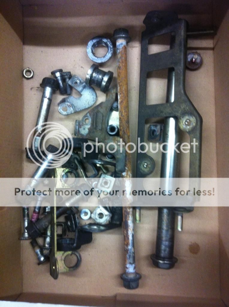

I am getting all the nuts, bolts, bits and bobs re-plated in zinc with the relevant passivated colour, clear (silver), dark green and yellow. To prep these I first de-greased everything, then to strip them back to base metal I pickled them in hydrochloric acid, (brick cleaner) this removes zinc very well but is best done outside....
when the bubbles stop then its done.
The acid dip....
Then I put them through the vapour blaster to clean them up..
I should pick them up this week so i can start putting things back together..

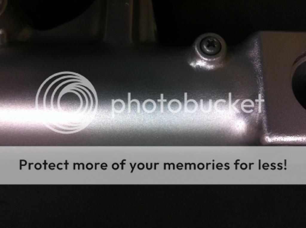

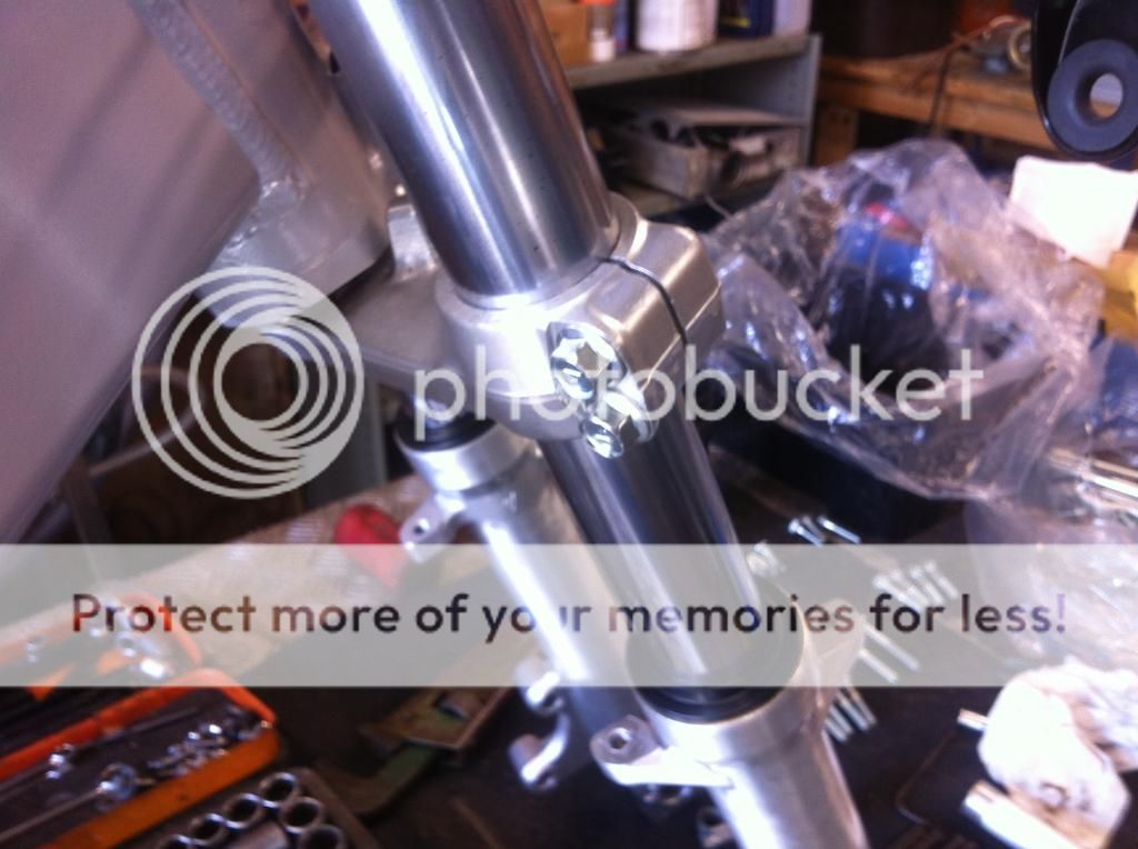

So while i'm waiting I made a start on the fork lower tubes, firstly I vapour blasted the tubes to get then clean, this gives a very nice finish but this does not look like the original brushed tubes..
So to give them a more original finish I re-brushed the tubes with 200 grit emery cloth,
I will lacquer these to protect them from the elements....

Forks, looks good, would scotchbrite pads be better? I have a feeling the original finish was sort sort of scotchbrite/lightly sanded and then anodised. 2k clear should work ok, I restored the top yoke like that, came out ok

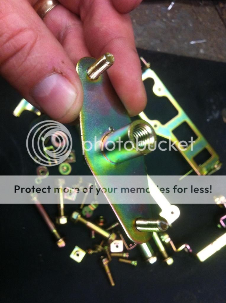

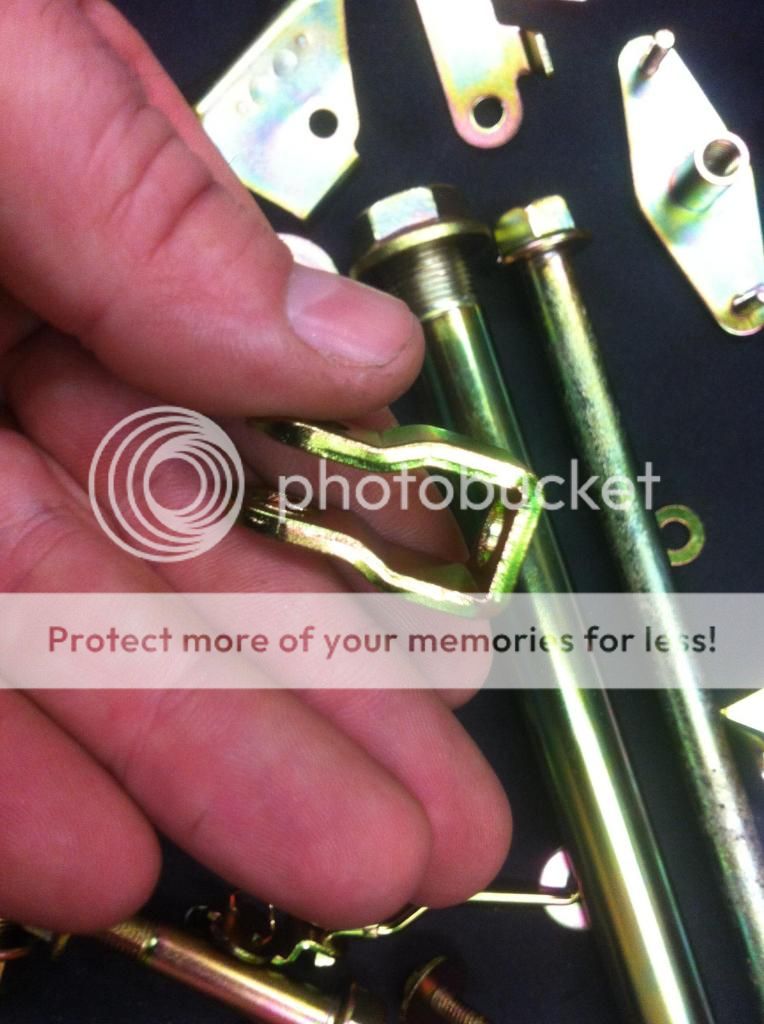

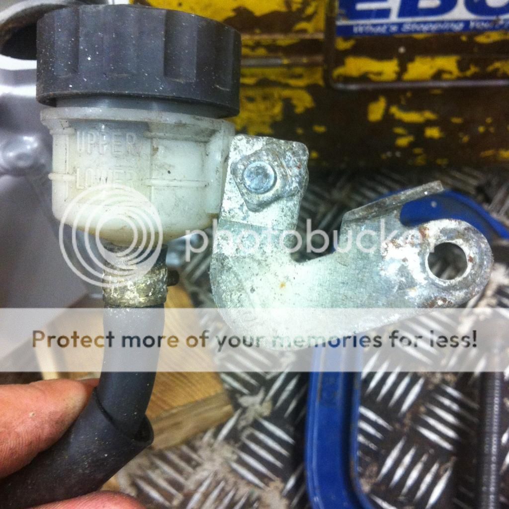

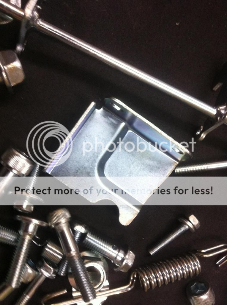

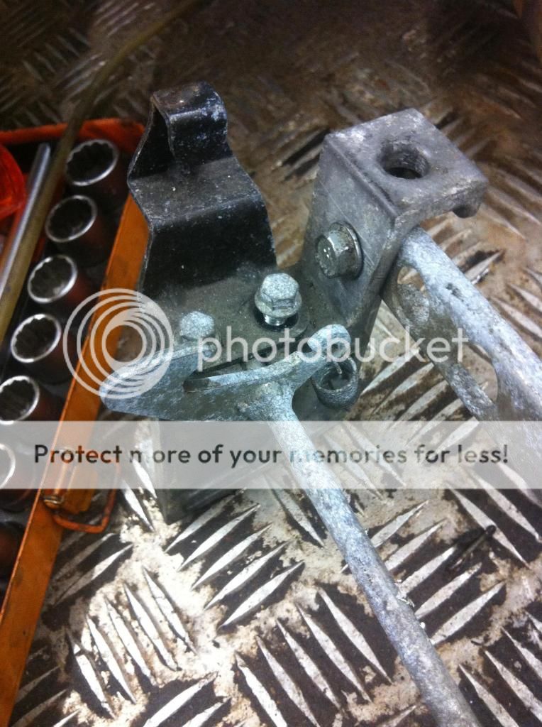

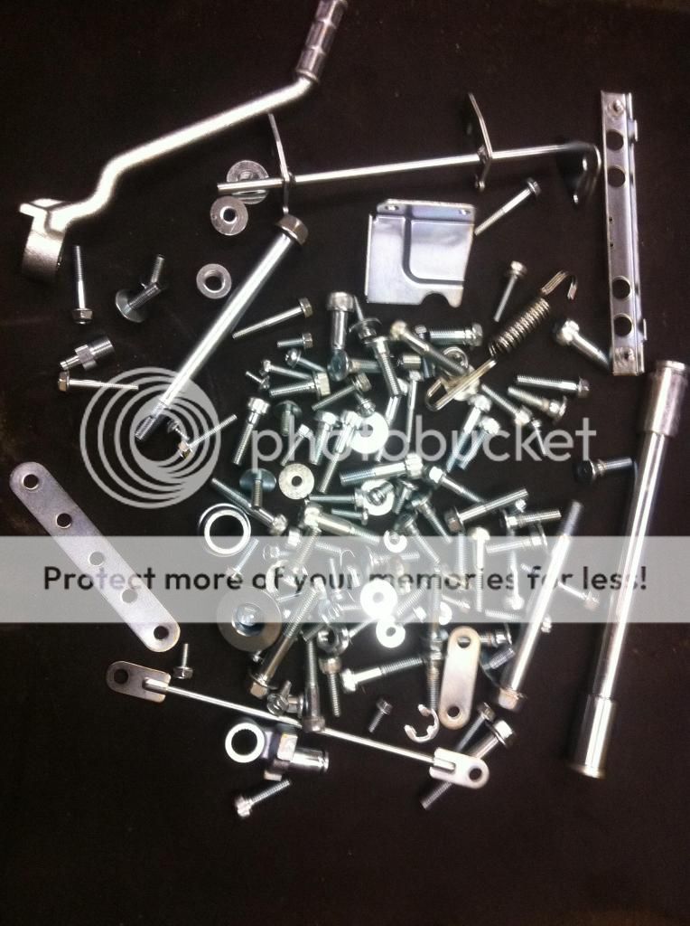

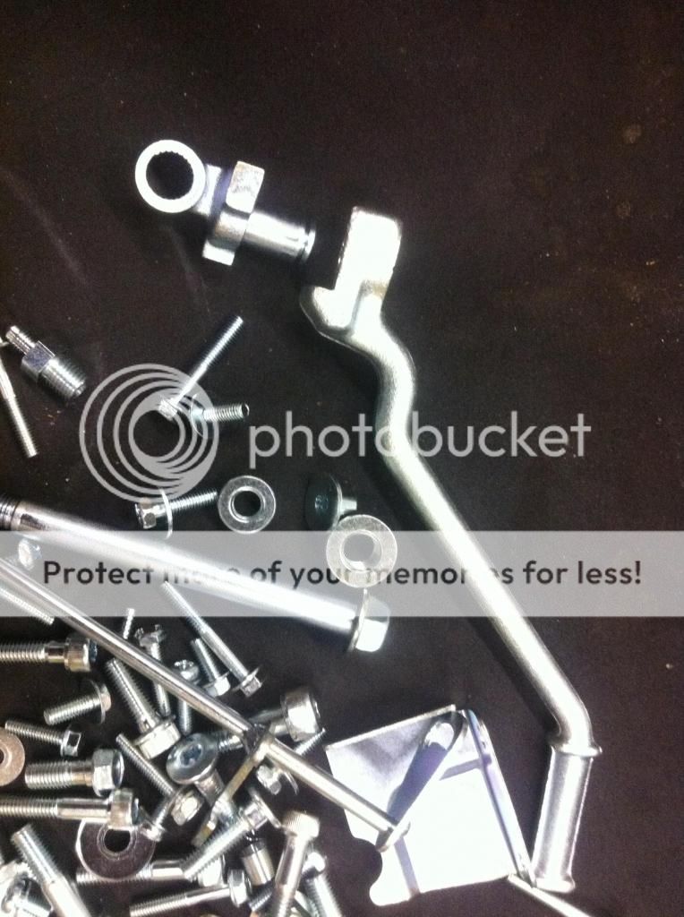

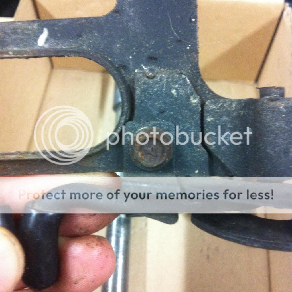

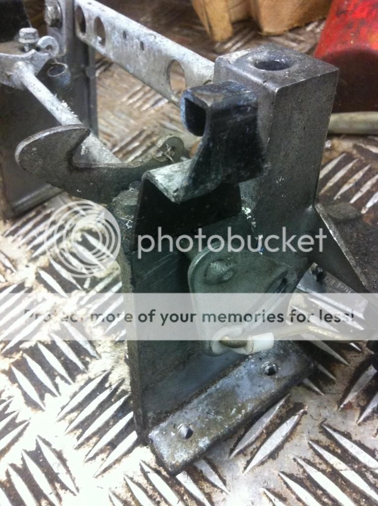

I picked up my bits and bobs from the platers, I'm very happy with the results.. I am still waiting for the dark green bits to be finished. here are some before and after photos,

out of interest what did the plating cost you, I like the idea of plating my own stuff but I can see having it down professionally being more cost/time effective, even if it's not so rewarding!
keep it coming!
carlsburg
Posts: 39
Joined: Fri Jul 01, 2011 6:22 am
Location: sudbury suffolk
Re: KR-1s restoration... getting started.
Post by carlsburg »
The Plating was done by a local company. I have used them before with great results, the lot cost me £75 + vat (£90) for around 6kg of parts. I consider that a bargain as the cost of setting up a simple zinc plating bath can be that, plus you have to add a passivate coating to the zinc (colour) to protect the zinc, this is where the pro's know what they are doing. I have looked around the plating company and to get good consistent results you need large tanks and a good deal of experience. My advice would be prep them as good as you can and hand them to someone that will make them look like new....

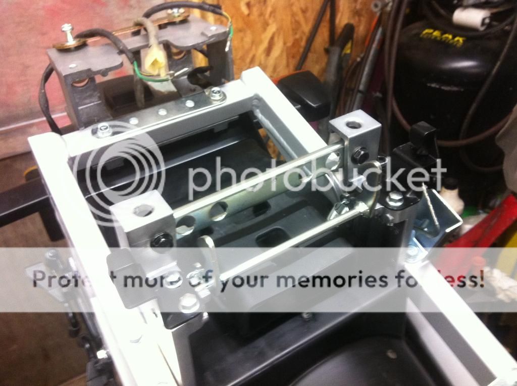

On the images of the plated items, what is the square flat plate? I don't recognise that (not something else I have lost #-o )

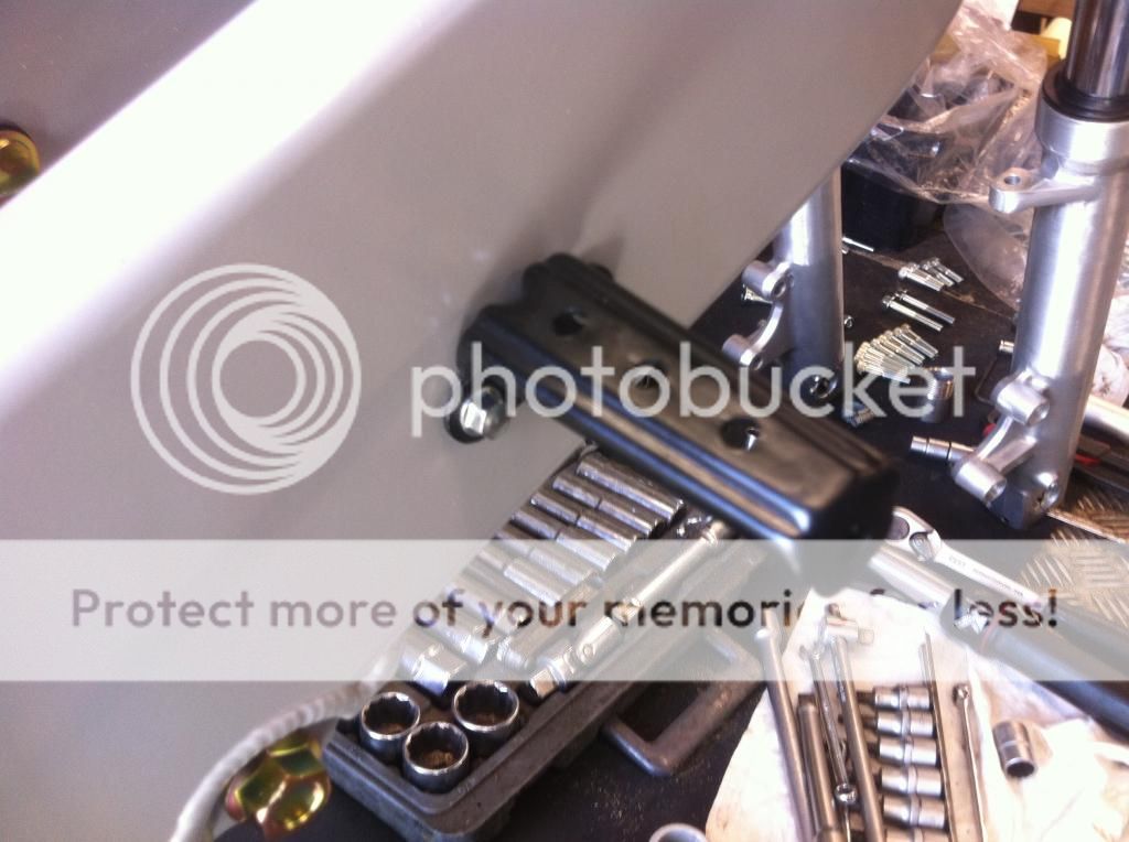

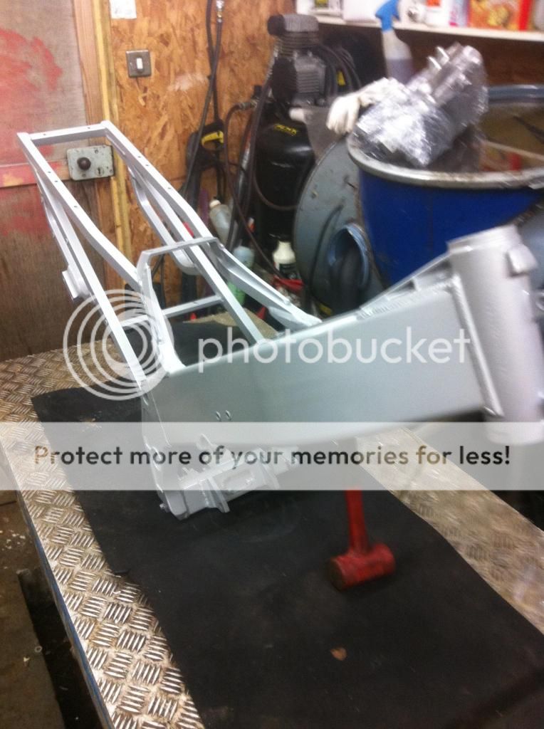

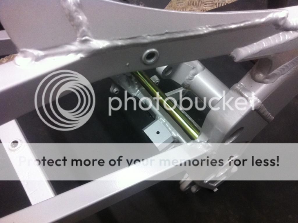

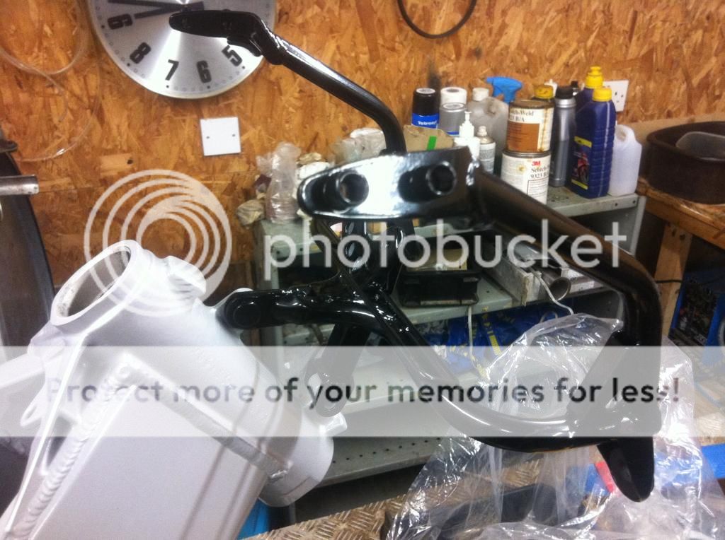

A few photos of today's progress.
