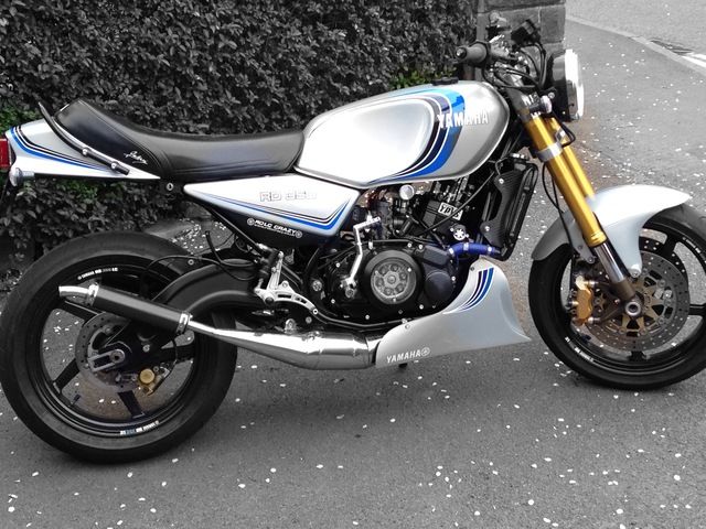

Nice pic of LC with Aprilia RS 250 wheels
I have a rear RS wheel and it looks like the cush side will need serious engineering to get the wheel and chain aligned :-k
Re: Marmite #2
That looks nice =D>
Posts: 3323
Re: Marmite #2
nice bike, except for that swing arm.
like many of those conversions, it is just too long for the bike and looks like one of those stupid american lengthened swing arm [-(
Posts: 2120
Re: Marmite #2
Post by headcoats »
Trouble with the standard LC,they are just like a moped with their spindly wheels etc so if you can add a bit of muscle to them then that's a good thing in my opinion .
Posts: 3323
Re: Marmite #2
I know.
but if it were my bike I'd make a custom swing arm without the added length :wink:
