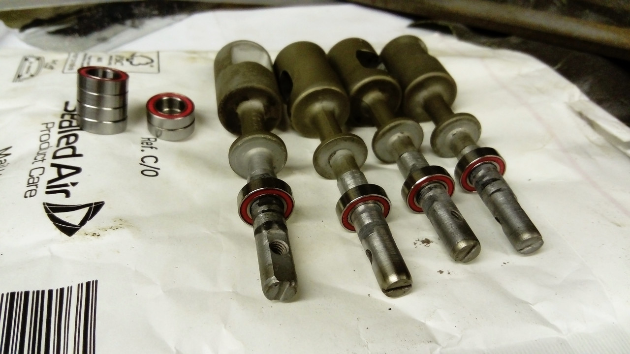

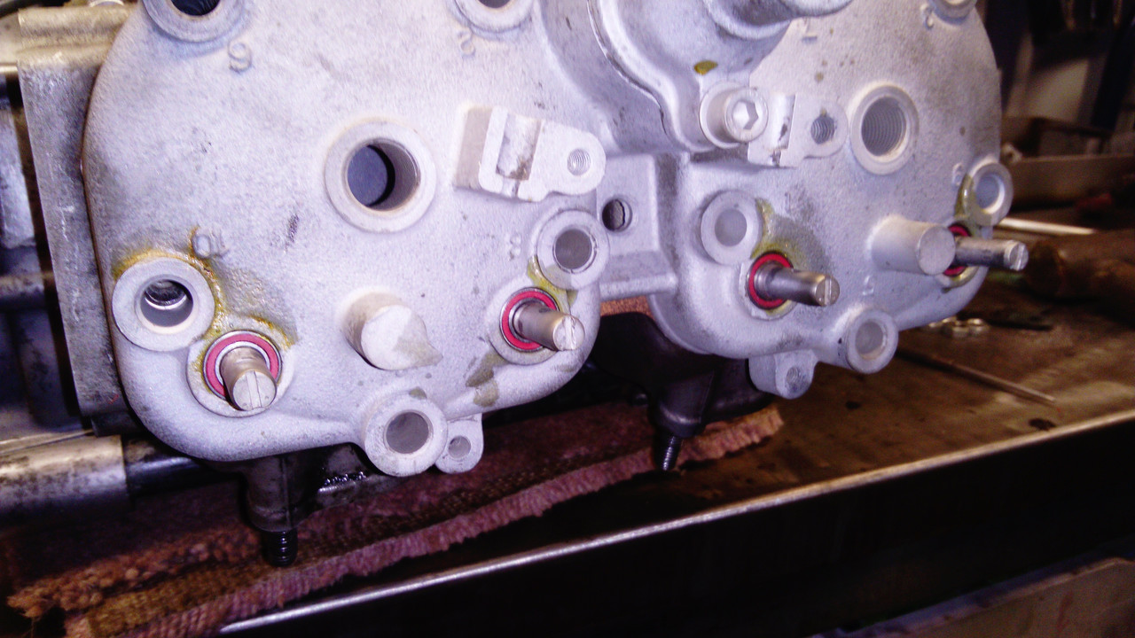

i can only find single lip seals . i will order some jb weld and i can etch the shafts so it sticks well , and thought i would try sealed bearings and sort 2 problems out , 8mm id x 14mm os x 4mm wide ,more surface area to stop everything rattling about ,hopefully .£10 for 10,we will see. ile have a look tomorrow to see if there is enough meat to counter bore into the seats to have a bearing and seal

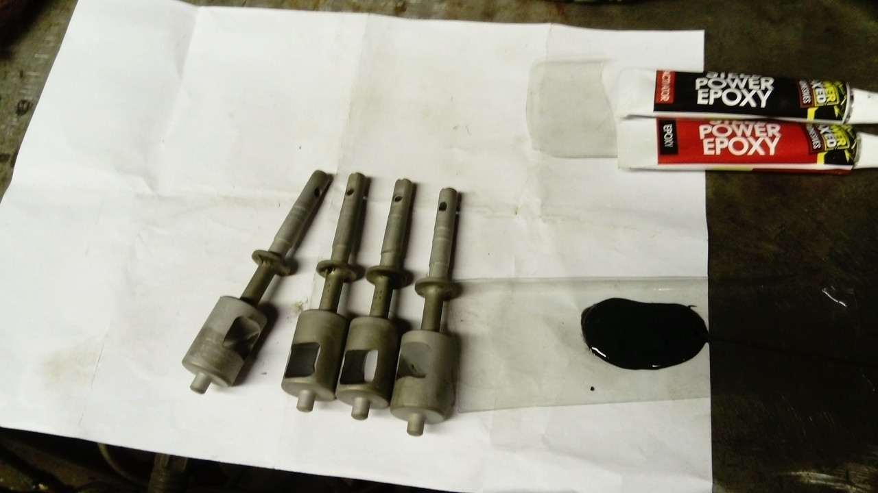

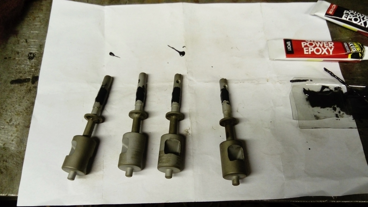

Just bought some Power Maxed steel epoxy to repair the wear on the kips valves. See how it goes.

probably why you are looking to improve robustness and save money at same time - if the finished tolerance on the stems is close enough, would you even need seals on top of sealed bearings?
the KIPS oil seal (92049-1238) is still available from Kawasaki ¥500 each - about £3.30
common with the KX85 apparently
http://www.kawasaki-motors.com/for_user ... g/Estimate
- Posts: 927
Re: Time for some tlc on mine
That's my thinking. Mine have always danced and bounced about a bit

Thats a good idea with the valves Fred, I have several that are worn ill give it a try
do you thi k any oil will be able to escape tho?, let me know how they perform cheers dan
- Posts: 927
I'll use a little Heldite sealer (used for petrol and diesel sealing over ptfe pipe joints) around the stem and on the outer race. I will pop the old seal above just as a damper, on a spare head I need to tig weld a snapped ring Mark up in the squish area so will remove the steel sleeves and counter bore in 3mm so a bearing and seal will properly fit. But that's a way off yet
