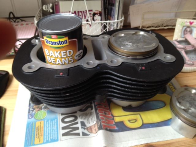

90mm 865 cc barrels arrived from a 500 mile bike :P
Re: Well it's Green and a bike !!!
Does this mean when you fit the barrels you can go out and give it some b...s :D
Posts: 2120
Post by headcoats »
Yeah I guess they were ready "run in "
Not sure though as they didn't mark the pistons left and right when the breakers stripped it, so not sure what I do here ?
Maybe need someone to measure pistons and bore :?: or is 500 miles OK to mix and match :?: , just take it easy for a few hundred miles :?:
Head is going to 2 stroke Guru Bob Farnham for a skim and gas flow :P
On the previous thread about shimming, he said that if I send the cams in the head he will shim it on the bench
Is this way just as accurate then ?
