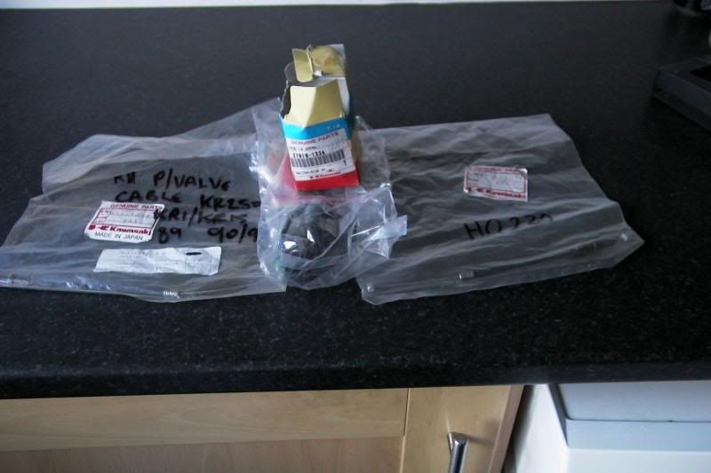

Sorted out a spacer for the bottom engine mount today. I have half a dozen of these so I thought I'd measure them up and use the longest one. There was a diference of 0.4mm between the one I used and the shortest.
Also - More new bits to fit.

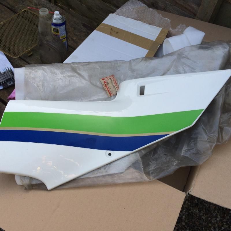

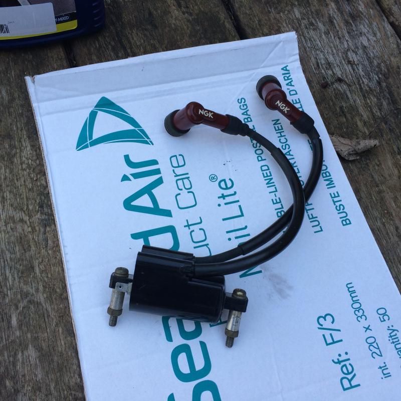

OK, time for a bit of an update. Encountered some issues with the engine and have been really busy at work.
The head gasket leaked so the top end had to come back off. I had the tops of the barrels ground as a pair and the head lapped. Also had the barrels honed again as there were some marks in bores and more new rings. Anyway all back together with a smear of High temp "h***a Bond" on the head gasket and all is well. A could of heat cycles in so far and seems to be running nicely.
So, back to putting her back together.
More NOS fitted.
