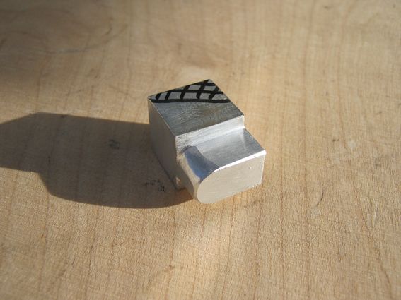

Finished lug in forward position in caliper bracket:
and in aft position:
Finished lug, rear end rounded to match rear end of locating groove. Crossatched area shows, very roughly, area to be removed to match inside of RH swingarm leg. Final dimensions to be determined when remaining spacer for rear wheel has been made.
Vertical clearance of lug is about 0.4 mm, side clearance to be about 0.2 mm.
