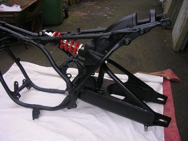

by headcoats » Fri Mar 13, 2009 9:40 pm
headcoats on Fri Dec 29, 2017 7:19 pm, edited 3 times in total.
SHimmer45
Posts: 1400 Joined: Tue Jul 25, 2006 7:51 pm
Post
by SHimmer45 » Sat Mar 14, 2009 11:25 am
nice i like that.
something cool about old skool steel frames that have been treated to some proper TLC
looking forward to the rest of the build

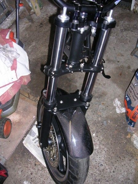

KR1S front end with a Buell M2 Mudguard
headcoats on Fri Dec 29, 2017 7:20 pm, edited 2 times in total.

by Bikemike » Sun Mar 15, 2009 10:06 am
Oh, that looks nice, more modern.
Did it just need a new alloy plate making up or was there more work involved?
Really looking forward to seeing it finished.
Mike
Posts: 2120 Joined: Sat Jun 09, 2007 10:10 am
Post
by headcoats » Sun Mar 15, 2009 10:34 am
I had an alloy fork brace made to fit the mudguard and had to jack it up on i think 10mm spacers so the mudguard cleared the tyre !!!
Alot of trouble i guess but i just didn't like the standard KR mudguard

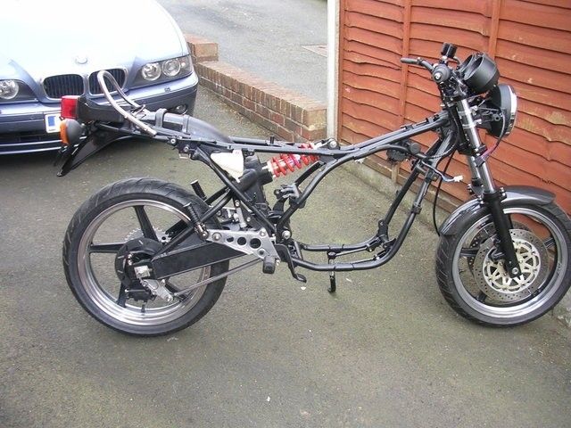

Bit more today
headcoats on Fri Dec 29, 2017 7:21 pm, edited 3 times in total.

It's nice to get them back on there wheels You feel like your getting somewhere =D> ..... Pic angle & colour of the back wheel make it look about 24" not 18"
. Alan
Post
by headcoats » Tue Mar 17, 2009 8:42 am
I was thinking that
24 rear and 16 front
